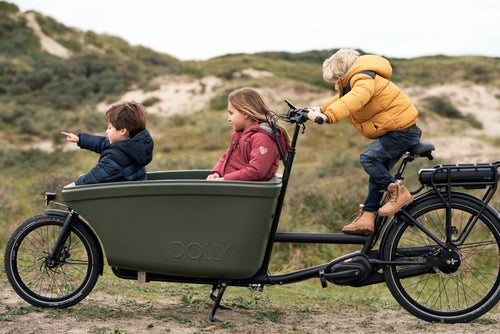

Something like a Dutch bakfiets now, no problem!
