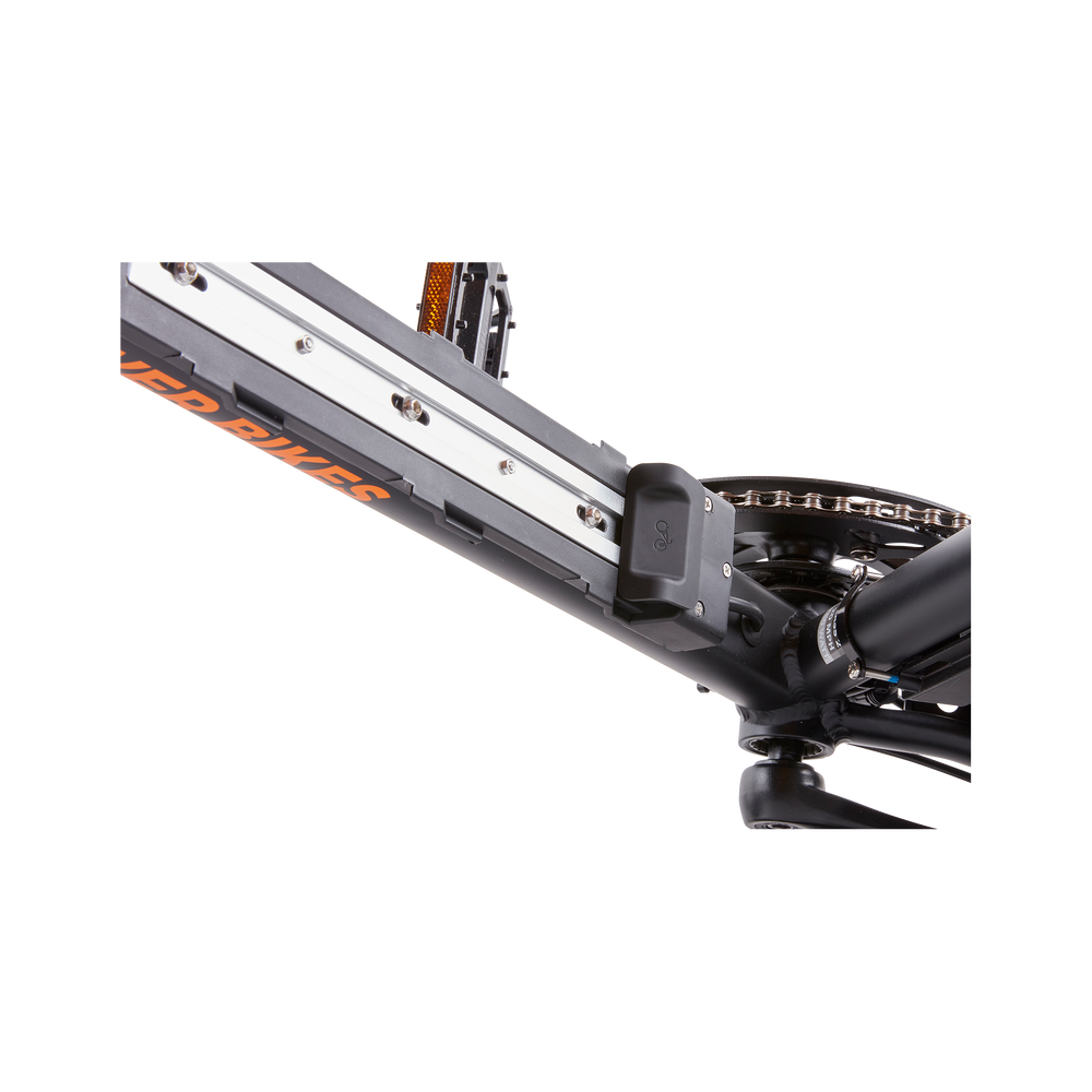

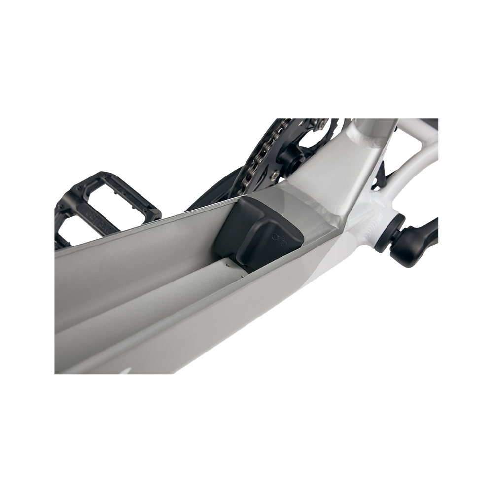

Rad Power Bikes has a "Battery Terminal Cover" for external and semi-integrated battery mounts.
